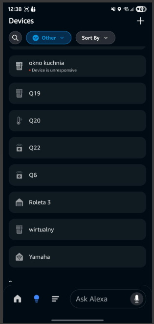

Sensors and Alexa
Yes you got right, we don't support all sensors in Alexa. Today we only get temperature sensor and contact sensor for gate (category other)
We got 2 reasons for it
1) there is a limitation device how much you can link in alexa, and you have limited time to send list of device
2) there is a limitation respons - when we trying to give all events from device like energy, all temperature etc we are over the limit, that way we focused on actors over sensors (shutter, light swith, light dimmers, plug, blinds, gates, RGBW,)
/monthly_2025_10/image.png.10262eff0aa330fdc9b03c91aae1786c.png">image.png
Based on changed i see more development and new features related to Google, like plan to introduce new speaker with Gemini new type devices and new Home Api, on Amazon side is more quiet
I am open to your suggestions and proposals. Let's figure out how to implement them without harming the actors, and the direction in which you want our integration to go
