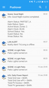

{v1.0}2) Network Device Monitor VD {v2.5} - vd that can monitor several + devices and has built-in alert notification options (pushover/pc2popup/hc2email/allinone)

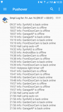

I use this to monitor Internet, Unifi Security Gateway, HC2, Sonos API (pi), TV's, Sat Box, Apple TV, Droid Box, Alarm Panel, Alarm Gateway, Syn NAS Global cache device, Cameras, Tablets, Sonos players, Access points and phones. Alerts setup for Internet, USG, Sonos API, Access points, cameras, Sonos players, Alarm panel, alarm gateway and NAS. There are some nuances with some devices such as TV's and Phones.

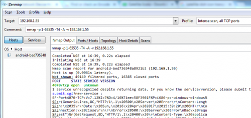

Open Ports of some devices that were shared by users

- alert = 1 (enable alerts - alerts sent if it goes offline or comes back online )
- alert = 0 (disable alerts for this device)
- Select the notification options
