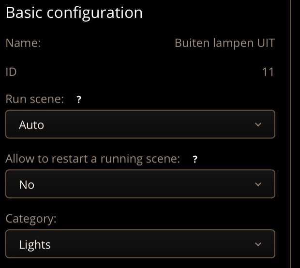

This was a half-joke but it actually works. If you set "Allow to restart a running scene" to 'no' (similar to "if fibaro:countScenes() > 1 then fibaro:abort() end")
you can code like this (almost like in the old days).

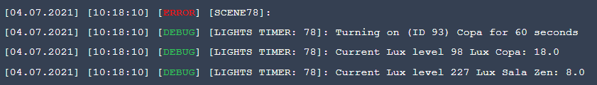

Hi guys, I edited the scene and runs for me (see code below).
I added check against lux, manual override and check if light is on or off all ready.
It runs like a charm but I think the pro's here can clean the code to make it better.
Conditions only check the motion sensor:
maybe this helps someone.
Jim
