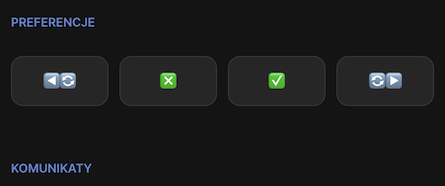

    Next issue is with the upload and interface. Here's the definition of interface:
    After upload it looks like this (also when using proxy):
    /monthly_2025_06/image.png.e1664ef17ada7972b89acf3c1b51061c.png" />
    It's ok. But when I go into edit on HC3, same interface look like this:
    As you see third line is missing.
    And if I try to change whatever (even single letter) in interface (in HC3) after save interface is empty.
    If I do it again (edit->any change->save), save is impossible and leads to error.
    Problem is generated by this evaporated line. It's replaced by a label with all fields empty. When I enter something in mandatory field, it saves, but third line still was lost.
    Also, I don't know if it's correct - update file task does not update changed interface. Interface is created only once, by upload.
    Edited by Łukasz997

    Ok, I tested your --%%u declarations and I saw that your last line is a line with 6 buttons.
    That is not really allowed on the HC3. It works as long as you don't try to open and edit the QA - then the Fibaro editor barks... and anything can happen...
    These kind of out-of-spec UIs I would reserve for QuickApp children as they are not opened and edited by users.
