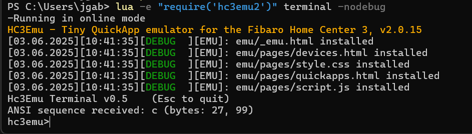

    The test if you have the path correct is to run in the Terminal app (on windows or mac)
    If the require finds the hc3emu2 module, everything should be fine (or can be fine :-) )
