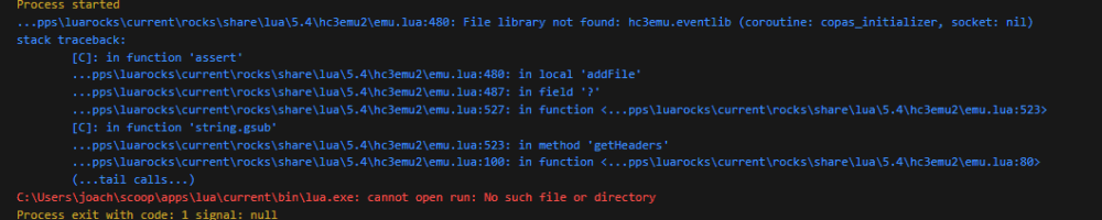

    Dear @jgab, I have tried to install hc3emu on my Windows10 version and following you instruction using scoop, all installtions were succesful (see attached text file 'Windows10 PowerShell hc3emu install log.txt').Before rebooting the PC, Fibemu was the only emulator working even using examples lua file in hc3emu-main directory.
    After reboot none of the is working anymore with following error message for hc3emu:

    I looked at your log that ends with the "luarocks path --bin" common. Did you edit the environment variables setting LUA_PATH and LUA_CPATH to the values shown?
    Second, in the terminal (powershell or commands), start lua and see if you can do require("copas")
    If that works, it means that you have installed lua, luarocks, and the the libraries, and that LUA_PATH and LUA_CPATH is setup correct.
    If all that works, then in vscode makes sure you have the launch task
    and the vscode extension lua mobdebug by Alexey installed.
    P.S also in terminal, do ">lua -v" to make sure that you have lua 5.4 or greater.
    Btw, the develop flag
    should only be used when running from the hc3emu repo, as it will use the local files in that directory instead of the ones installed by luarocks.
    See powerSell error below which seem to be the same as when using hc3emu:
    /monthly_2025_03/image.png.5e9d493021376893037d45d47b7e0972.png" />

    I still have the same errors for fibemu (global 'QuickApp' is nil) and for hc3emu-main (not a valid Win32 application)
    I think I have the right version for lua:
    PS C:\Users\ASUS\Documents\hc3emu-main> lua -v
    Lua 5.4.7  Copyright (C) 1994-2024 Lua.org, PUC-Rio
    It looks like you haven't managed to build the right libraries for luasocket (or luasec).
    ...or you have built the right version but not for the lua that you run (seems to be a wrong type of the dll' 32bit vs 64bit or something)
    Can you check that the lua you are running is also coming from the scoop installation?
    Your problem could be an old installed lua that gets in the mix...
    It can also mean that you haven't installed luasec (tried to google on the French in your log...)
