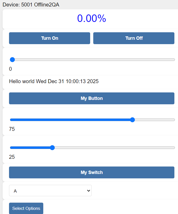

    But when I try your example QA_offline_UI.lua I have 2 errors in the log:
    Could not connect to 127.0.0.1:8818: timeout
    [07.04.2025][13:04:38][SYS]    Parsing examples\QA_offline_UI.lua directives...
    [07.04.2025][13:04:38][SYS]    emu/_setup.html installed
    [07.04.2025][13:04:38][SYS]    emu/_emu.html installed
    [07.04.2025][13:04:38][SYS]    emu/pages/editSettings.html installed
    [07.04.2025][13:04:39][SYS]    emu/pages/quickapps.html installed
    [07.04.2025][13:04:39][SYS]    emu/pages/style.css installed
    [07.04.2025][13:04:39][SYS]    emu/pages/devices.html installed
    [07.04.2025][13:04:39][SYS]    emu/pages/script.js installed
    [07.04.2025][13:04:40][SYS]    Starting webserver at 0.0.0.0:8265
    [07.04.2025][13:04:40][SYS]    Main QA file examples\QA_offline_UI.lua
    HC3Emu - Tiny QuickApp emulator for the Fibaro Home Center 3, v1.0.76
    [07.04.2025][13:04:40][SYSERR]    Missing hc3emu.URL - Please set url to HC3 in config file
    Then I discovered that in QA_offline_UI.lua the directive was --% %offline= true, chage for correct directive and getting thes log messages:
    [07.04.2025][13:32:03][SYS]    Parsing examples\QA_offline_UI.lua directives...
    [07.04.2025][13:32:03][SYS]    emu/_emu.html installed
    [07.04.2025][13:32:03][SYS]    emu/pages/devices.html installed
    [07.04.2025][13:32:03][SYS]    emu/_setup.html installed
    [07.04.2025][13:32:03][SYS]    emu/pages/script.js installed
    [07.04.2025][13:32:03][SYS]    emu/pages/editSettings.html installed
    [07.04.2025][13:32:03][SYS]    emu/pages/quickapps.html installed
    [07.04.2025][13:32:03][SYS]    emu/pages/style.css installed
    [07.04.2025][13:32:04][SYS]    Starting webserver at 0.0.0.0:8265
    [07.04.2025][13:32:04][SYS]    Main QA file examples\QA_offline_UI.lua
    [31.12.2025][10:00:13][SYS]    Time set to Wed Dec 31 10:00:13 2025
    [31.12.2025][10:00:13][SYS]    Starting QuickApp 'Offline2QA'
    [31.12.2025][10:00:13][DEBUG ][OFFLINE2QA5001]: Offline2 QA started Offline2QA 5001
    _emu.html is giving:
    /monthly_2025_04/image.png.33d4723a8f42497d0414844a4b6e5540.png" />
    And Offline2QA.html
    I can see that all QA buttons are working with no error.
    New Questions:

    • Do you know a way to have the html Device View in my usual web browser? I will be easier for me to use the web view on another screen and look at the DEBUG CONSOLE or make change to the code?
    I have found that copying the link at the top of the inbedded web server I can get the same in Firefox😏.

    54 minutes ago, Christb said:
    I suspect a format error in my self:updateView(...) even they were working in fibemu; I know it is some time difficult to find the problem as no error message, just the command is ignored (like in fibemu).
    In fact this not an updateView issue but the refresh of the html view (my code is in fact OK).
    As in fibemu, is it possible to add a directive to refresh automatically the html view? or inside a setting file?
