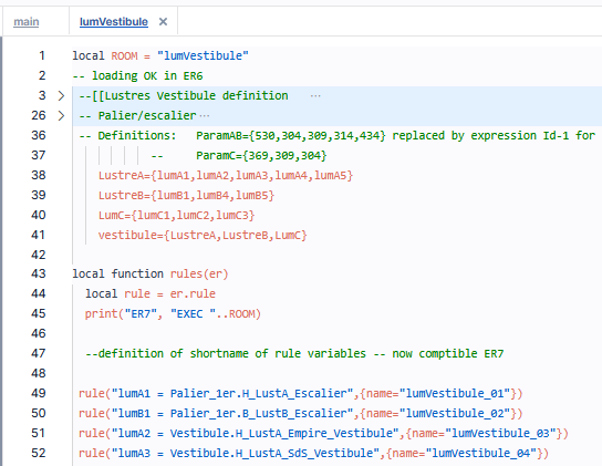

    Hy @jgab, did you change the way to declare rules in a QA additional file?
    See below:
    /monthly_2026_05/image.png.3159875e7d0c55e984401f1d62ca4a1f.png" />
    with in additional file 'lumVestibule':
    gives error:
    [27.05.2026] [16:24:50] [DEBUG] [QUICKAPP769]: EventRunner 7, v0.1.15
    [27.05.2026] [16:24:54] [DEBUG] [QUICKAPP769]: ER7 REG lumVestibule
    [27.05.2026] [16:24:55] [DEBUG] [QUICKAPP769]: =========== Loading rules ================
    [27.05.2026] [16:24:55] [DEBUG] [QUICKAPP769]: ER7 QuickApp:main() start -> running Libraries)
    [27.05.2026] [16:24:55] [DEBUG] [QUICKAPP769]: ER7 EXEC lumVestibule
    [27.05.2026] [16:24:55] [ERROR] [QUICKAPP769]: timer handler failed with error: ./include/lumVestibule.lua:49: attempt to call a nil value (local 'rule')
    See below:
    gives error:
    There is a "new" way to declare user modules.
    Note that the QA file's name need to start with an 'x' or it will be removed if you run update with QA Dist.
    I have found that changing rule=er.rule by rule = er.eval, all the rules are now loaded.😀
    I now need to find why some of these rules are showing errror with " Undefined variable:".
    Sure it is comming from the file paste from ER6 to ER7 QAwhich need some changes as the compatibility between 6 &7 is good only with standard rules but not with option like:
    rule("name1","condition => action") which is now rule("condition => action",{name="name1")
    It worths to make the changes as you add the group feature that was present in ER5 and lost in ER6 and new interesting features.🫠
