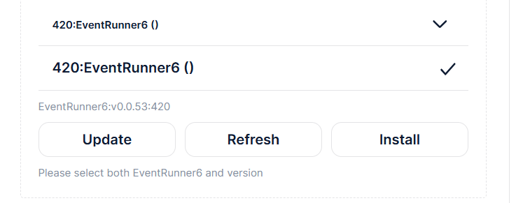

    @jgab ok will try the new ER! So i'm trying to use ER updater
    What do I press and should there be a popup or something in the logs ;-)
    Update gives:
    [2025-10-28] [20:05:09] [ERROR] [QUICKAPP421]: Please select both EventRunner6 and version
    (separately: It did take an unusual time (IMHO) for the 2nd and 3rd dropdowns to populate when first installed - they were blank onInit even when I select ER6 in the first dropdown)
    In the meantime, I have updated manually and will monitor over next few days or so.
