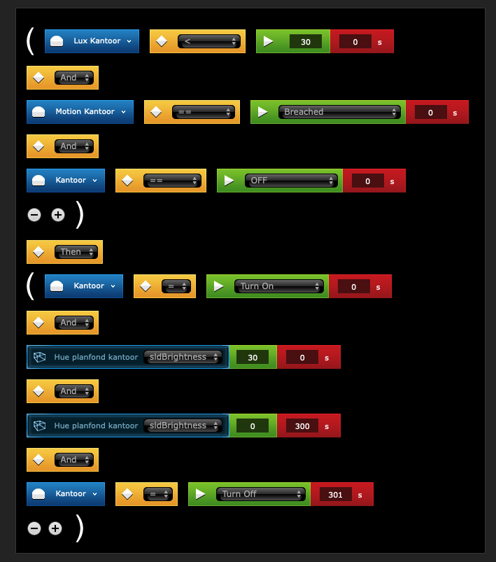

inbedrijf
Hello,  i'am totally new here, but i got my HC2 working fine and now i'am trying to add HUE to my setup, i have one HUE lamp and it is connected to wall socket that is Z-WAVE so is made the Block action, and this works for 99% the only thing that isnt working is that when the light is off and gets triggerd again the brightness is 100.... Can someone help me....
Guest Sankotronic
Hi @inbedrijf ,
I think that you don't need to use any other devices on HUE lamps. Just remove that wall socket and use it for some other purpose. HUE lights can be remotely turned off and actually to be able to control them remotely they must NOT be switched off by switch. Using HUE plugin or HUE AIO VD is enough to control HUE lamps.
