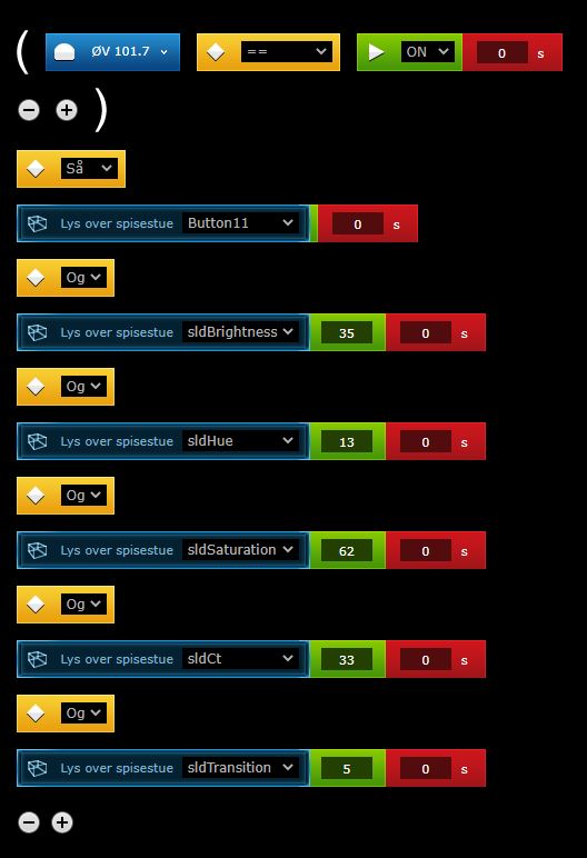

I have happily been using the Philips HUE AIO VD standalone 3.1 for some time.
However one thing is bugging me.
I have a button “101.7” activating a scene, which turn on 2 lights ( I have made a group “Lys over spisestue” in the HUE bridge)
The scene defines the different levels, as you can see.
However, the levels is not right when I call the scene on the button, not even if the lights are switched off at that level.
Especially the brightness level makes a peak and then quickly adjusts down to the defined level (35%)
Is there a way to avoid this peak?
I have several groups acting the same.

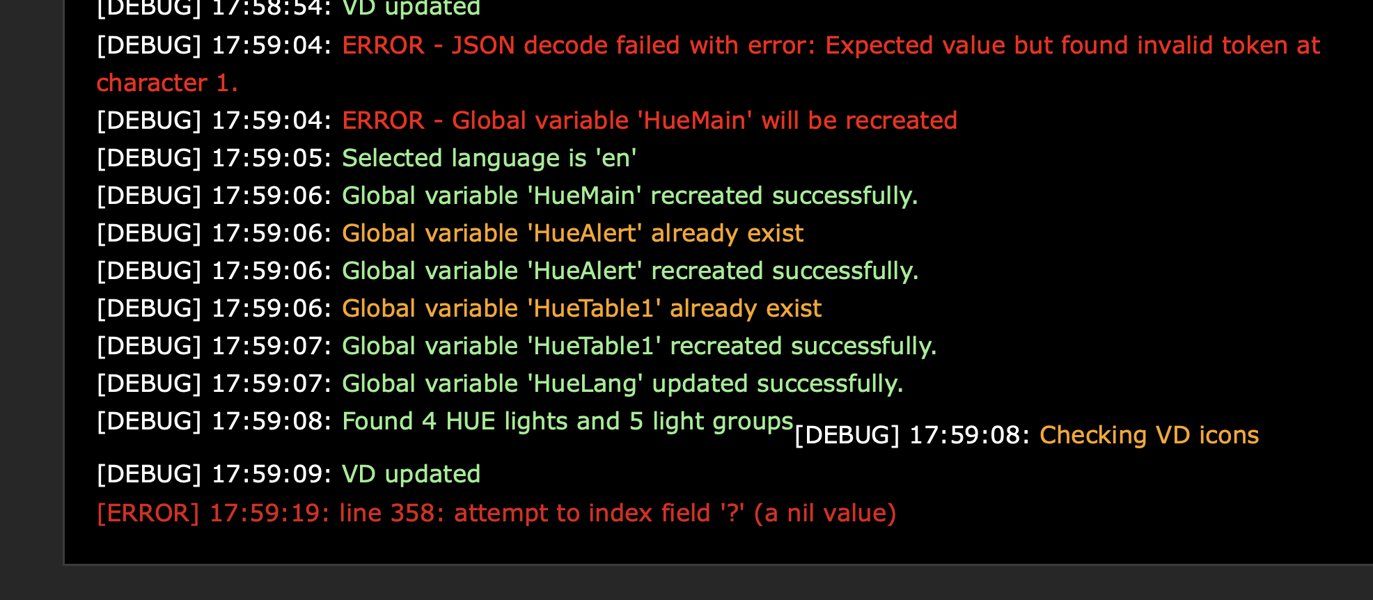

In the main loop i got an error from the virtual device: The "SA HUE Preview 1.1". See attached
The only way to resolve this is to restart my HC2
How can this be fixed?
If you need more info let me know.
HC2 V4.620
Sankotronic
Hello @samuel,
From debug screenshot it is clear that global variable content is lost and VD is rebuilding them. ERROR is caused by missing data, which is odd since data should be renewed before that part of the code is executed.
I looked at the code and found bug. It is all about language settings. After rebuilding global variables language is not set in the first run and therefore code stops on error.
Solution is to change code line 168 which is now:
  local langTable=json.encode({language="",
to
  local langTable=json.encode({language=lng,
This should solve problem with code ERROR.
