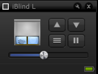

    15 hours ago, michal85pl said:
    Is that for all your devices?
    Do you get a log like "binary switch 146 batteryLevel=60" ?
    When I try I get a
    /monthly_2020_09/batt.png.ed0a24e063c04e0421d85402a8bb46ac.png" />
    I have also empty batteries on motion sensor, D/W sensor and battery powered rollerSchutters...
    When I try I get a

    I have also correct battery levels reported in the logging, but displayed as 0% :-(
    [12.09.2020] [11:01:57] [DEBUG] [QUICKAPP802]: Call HC2:http://10.0.0.50/api/devices/1173
    [12.09.2020] [11:01:57] [DEBUG] [QUICKAPP802]: multilevel switch 1173 value=40
    [12.09.2020] [11:01:57] [DEBUG] [QUICKAPP802]: multilevel switch 1173 batteryLevel=100
    Edited by Bodyart
    This is magic....
    Can you do me a favour, edit your current QA and around line ~280 there is main() defined, add in the beginning:
    where you change the 1374 to the HC3 id of a childDevice that has battery value 0% - and see if it gets updated to 77%
    /monthly_2020_09/afbeelding.png.b6db377020af8c3456537f4b82958845.png" />
    yeapp
    I've outremarked that line again but the battery level stays on 77% :-D
    Edited by Bodyart
    9 minutes ago, Bodyart said:
    yeapp
    Ok, one more test. Around line ~150 there is the function (for multilevelSwitch) that updates the battery property and logs the
    "multilevel switch 1173 batteryLevel=100"
    Could it be that the property value arrives as a string?
    Can you add a tonumber around the value argument? (and 'or value' in case it's not a number)
    Like
    Like
    I see you use it for rollerShutter - I think we could do a childDevice class that fits better the rollerShutter and makes the buttons working.
    Y E S !!!
    That fixed it, happy now :-D
    Probably we need to change the other updateProperty occurencies, because my Motion sensor and D/W sensor also show zero battery.
    5 minutes ago, Bodyart said:
    Y E S !!!
    Ok, here is v1.9 with the fix
    • Thanks 2
    I have changed also other occurencies and now having all batteries displayed :-D
