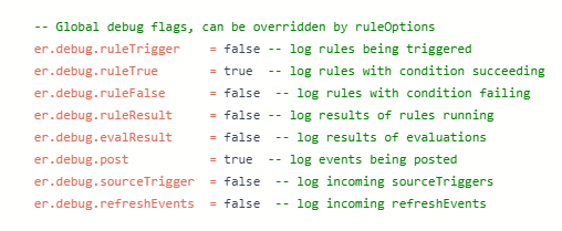

    @jgab Jan, how can I differentiate rules being logged on UI with some colors. I would like to see rules that are evoked but condition failed in red, and rules that met conditions and are triggered in green. Should i create a custom function for this or there is an inbuilt option for this in ER5?
    /monthly_2023_12/image.png.5aca5dc64fc74e68da0347e8998b2a08.png" />image.png.c5babaf74571d7ab389cbcaf415a5bf4.png
    No, not in the UI. The routine that logs this in the UI needs to be rather quick as not to slow down ER too much.
    If we want to do more fancy stuff here the logic needs to be different - like buffering and update every 5s or something like that.
