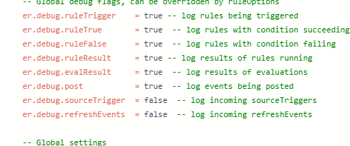

    Jan please, what is happening...In customers house i cant see a single line of events
    /monthly_2023_12/image.png.e78facd32540c722fa9c604de68bed7e.png" />
    rules defined, but no events showed
