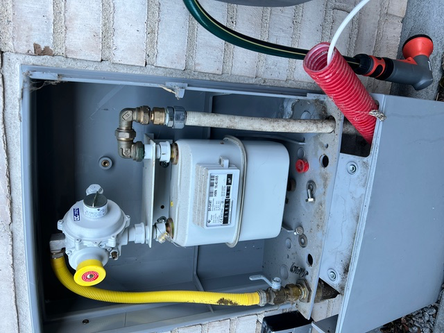

@ChristianSogaard your gascounter looks very nice can you please send me the QA?
Im using this, to count the Pulses - with a reed switch .
/monthly_2024_01/image.png.ebd326463944abf42dbc822a476afe07.png" />
and Eventrunner 5, with these rules
