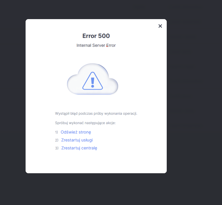

I tried add this QA but during installation i got this error. Do you have any ideas ?

Hi @Artwal,
Error 500 that you have has nothing to do with Netatmo Weater station QA, but with the way you are adding it. Are you adding it connected remotely? Maybe it is time to clean your browser cache that can also cause this problem. Also, are you logged to the HC3 as Admin or normal user? etc. etc.
