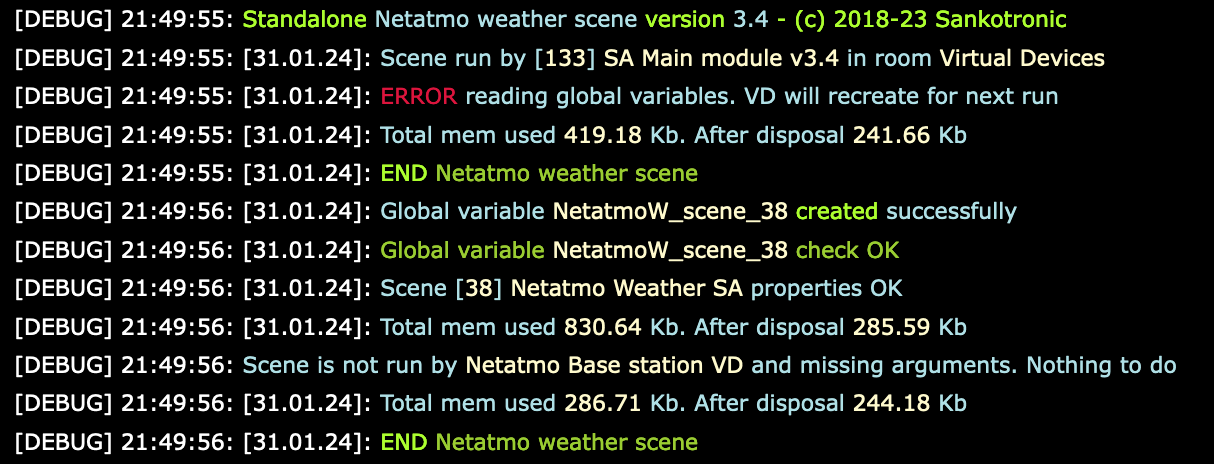

Since yesterday I started receiving following error in the main scene:
[DEBUG] 10:10:09: Standalone Netatmo weather scene version 3.4 - (c) 2018-23 Sankotronic
[DEBUG] 10:10:09: [13.07.23]: Scene run by [904] SA Main module v3.4 in room Vardagsrum
[DEBUG] 10:10:09: 2023-07-13 10:10:09.585991 [ fatal] Unknown exception: /opt/fibaro/scenes/120.lua:78: attempt to concatenate global 'refresh_token' (a nil value)
I'm then also bombed with errors from the wing gauge VD:
A Wind gauge v3.4 (:arrows_counterclockwise: ) [id: 978(7)]
[ ERROR ] 10:09:39: line 41: attempt to call global \'debug\' (a nil value)
Any ideas?

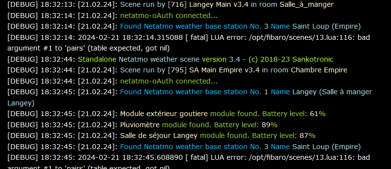

If I push the refresh button on VD, I still dont get the data. Debug VD gives following error:
However (as indicated in my previous message) the scene is well present...

Hello Sanko,
I have installed v3.4 Netatmo VD in my 2 HC2 (v4..63) and get recently 2 issues:
1) For one of them I can see frequentmly all modules with data error log message.
I can fix this by just saving the Netatmo scene (without any change) and all modules are showing informations for a while:
I need to make the same procedure around every 3-4 weeks.
2) On the second one, I have now all modules with data error log message:
       - Saving the scene does not change anything
       - Suppressing all variables and launching the scene has not result
       - I have copied credentials from working HC2 into the scene of the second one without any success
Looking at all debug window I cannot see any error message :

Do you have an idea of what went wrong?
r
Christb
I still have all my modules with "Update error" and try to get new tokens but this does not cahnge anything.
Is there a way to know if the Netatmo server is answering to HC2 requests?

Christb
Thank you for your answer, I think I have followed your described steps 2 weeks ago and all modules are working again but it has not been the case immedialy after the change (I don't know why). All ok now.👍
Christb
I have a standalone main module #3 which does not have anu other modules: when adding it, the modules seems to work but in the Scene I get a fatal error:
image.png.a4ba3642f828abf909fd191c8b9c6280.png image.png.5949f75aedbb44d1b81f98453a13b106.png
Do you confirm that the external module is manadatory to have the VD Main Empire working?
