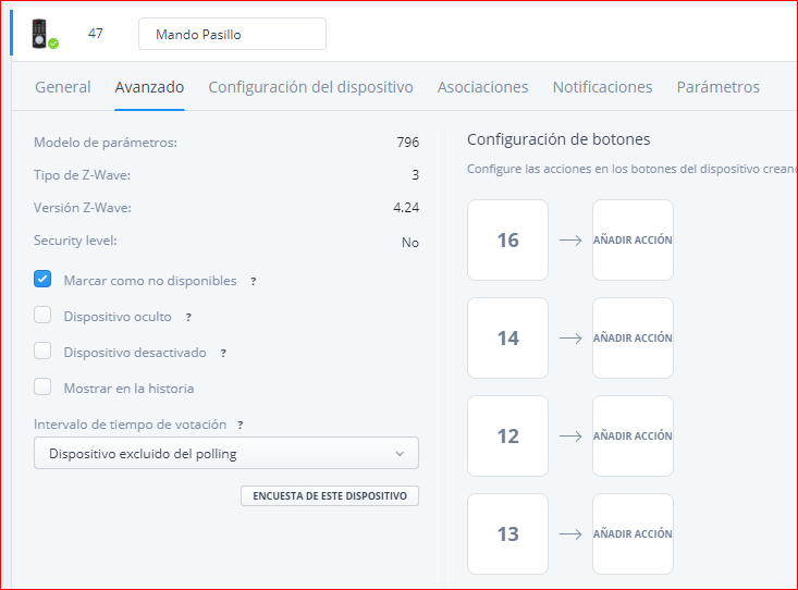

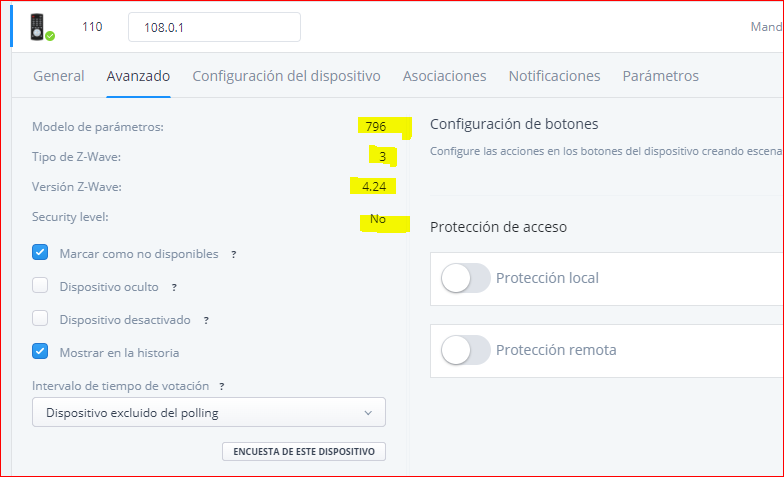

    Guest Benrive
    I am seeing something that seems really strange to me, having the parameters exactly the same in different Dimmer2, in some I can see several scenes and in others only 1 posivilidad.
    Why does this happen? The parameters are the same in all Dimmer2
    All Dimmer ara the same parameter, same model and same firmware.
    Dimmer2 only one Scenary
    /monthly_2021_12/image.png.ff467eebed90c42fda2f7aa82177e945.png" />
    Dimmer 2 No scenario
    Dimmer witch 4 scenary
    But now I have recomplete configuration and , i dont see any scenary .
    I'm crazy
    Edited by Benrive

    Have you seen how my Advanced screen changes in the Dimmer 2 , being the same confiuration, parameters, and versions?.
    I'm going crazy, I can't understand why the 4 scenes don't appear at all 16-14-12-13.
    I have restored the backup I made a few days ago with version 5.090.17 because I had the BETA, but I have not been able to solve anything with it.
