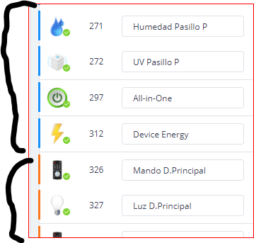

    1-. The exslave defined it within the general configuration as an exslave. So I have all the devices within the same Yubii App and I manage everything from the master device.
    /monthly_2022_02/image.png.89a4c17338432921f19d9a74770b515a.png" />
    I have unlinked the devices near this from the master and linked to the slave, but they all show up on the master.
    In blue the devices of the master and in red those linked in the slave
