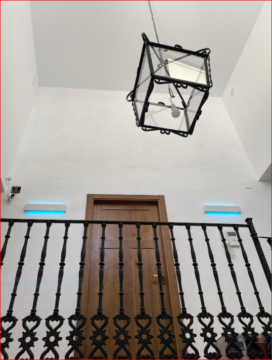

    I have finished installing the ambient lights in the entryway of our new house.
    Currently I have put these JM lines to be able to act on the button.
    Scene One Click ( Mode Aurora )
    Scene Two Click ( Mode Only White )
    I automatically activate the "Aurora" scene, it is the one that most closely resembles what I want.
    I want to give showiness to those high walls.
    Can you think of any way to do it through some sequence in LUA, imagine that it would be to set the scene as if it were a museum or something similar.
    I'll pass you pictures of where they are and how it is so that you can get an idea of what I intend.
    /monthly_2022_02/image.png.6b89654f918cf720e796c450a9651174.png" />
    Thanks in advance
    Thanks in advance
