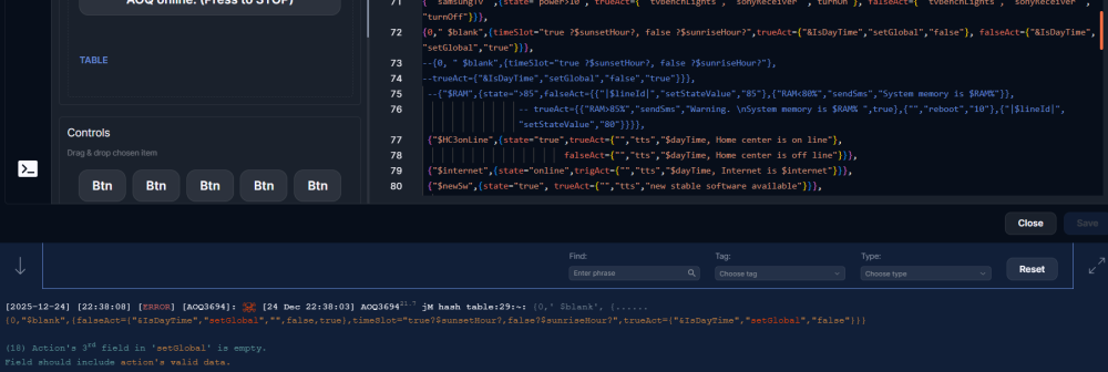

    I have  moved some more magic scenes to All-in-One scene. I have problems with the send push function. The Push messages will only send to the iPad. Every other mobile phone won't receive the push messages (iPhone or Android). With my other alarm scripts I receive the push massages with every device. Could this possible? Is there a difference between the iPhone or iPad push message?
    The code above leads to an error:
    BUG] 17:29:26: 2019-12-27 17:29:26.349761 [ fatal] Unknown exception: /opt/fibaro/scenes/185.lua:298: attempt to index field '?' (a nil value)
    Is this part right? I have searched for a mistake but I couldn't find the reason for the error.
    ?$timeSpan*60+($timeSpan/10*60)?
    exg. 2 Minutes
    2*60 = 120
    2/10*60 = 12
    132 sec.
    Manuel
    Share this post
