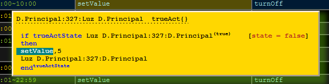

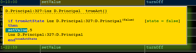

    7 hours ago, cag014 said:
    {0,"`LuzDPrincipal`",{state="sceneActivation=16",timeSlot="23:00~08:00",trueActState={"if {`LuzDPrincipal`:state=false}"},trueAct={"`LuzDPrincipal`","setValue,5"}}}, {0,"`LuzDPrincipal`",{state="sceneActivation=16",timeSlot="08:01~22:59",trueActState={"if {`LuzDPrincipal`:value=0}"},trueAct={"`LuzDPrincipal`","setValue,40"}}},
    I have tried this line in 2 different ways, here I detail it ( only timeSlot="08:01~22:59" ),The rank where I am at the moment.
    Test One Value=0
    It does nothing, this only appears when I press 2 times to increase the intensity to the maximum and when I press again then it executes the action ( no action ).
    When I press it turns on and when I press again it turns off, this always works
    I can see the trace when the light is on and I press to turn off In both cases Value or Status
    Test Two State=false
    The same that value=0
    This Its correct, but i dont know because dont work.
    trueActstate is false, but the light turn on witch the last value but not 40
    /monthly_2022_03/image.png.44910a569d48df629f6ea27991eaae6a.png" />
    Edited by Benrive
    As you can see the lights are ON...  and lines not executed
    Shows value=99 in condition
    Shows state=true in condition
    As I said if no one turns lights off the line won't work

    First of all I glad to hear that it works
    Just curious if you have an example when state=false and the line doesn't work
    Your snapshot shows that current state=true (when the condition displayed, the current state of each device shown also, see red arrow below)

    Hello @cag014?
    After trying this morning, since we spent the weekend away, I can say again that it does not work.
    The problem is that when the light goes turnOff both State=false and Value=0.
    because in this line the state will never be fulfilled trueActState.
    Before executing the line we have state=false and value = 0
    So the condition is not met trueActState.
    But even if I remove the value>5 condition, the condition is not met either.

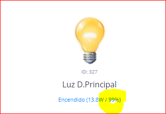

    Here you can see an example of when state = false does nothing, it doesn't recognize what it should do.
    /monthly_2022_03/image.png.2c3ff03e88b72b942b059d684f814425.png" />
    In this situation, I press the button Result sceneActivation=16
    The light turns on but does not recognize the scene or change the value to = 5
    Time it's 08:39 and push the botton
    In trace log nothing is seen, and in webEye it does not recognize that the scene has been executed but it has updated the values.
    If I remove the conditional value>5 , it should work perfectly since all the conditions are met, but the same thing happens.
    When I push the button, the light comes on, the values change but it still doesn't do anything.
    And value = 99

    If I keep the line as simple as possible.
    trueActstate condition is never executed when actually pressing State=false and condition it'ss true.
    I've made the line as simple as possible, but it still recognizes when it's true.
    Here when i press , and the state is false ( Turn Off the light )it should do the trueact action, but it doesn't do anything.
    That's the problem in all of this.
    On the contrary, if it recognizes the action trueActState if the state = true . Although in that case, it must execute the action FalseAct.
    When status=true , but not when status=false
