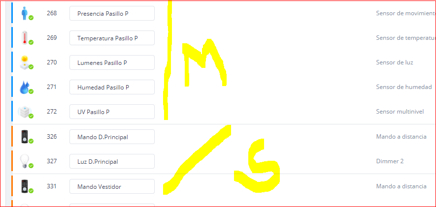

    LuzDPrincipal with id=327 is a device located on your slave, while LuzMarina with id=96 is the same device located on your master, is it correct?
    Yes, Its Correct ,but I have all devices visible on the Master
    Master and slave communicate through LAN Rj45
    /monthly_2022_03/image.png.2d9e1d32b394166eea99afc8732b8531.png" />
    30 minutes ago, cag014 said:
    If my observations are correct, LuzDPrincipal is not a valid device for AOQ. (you probably have some other device ID=327 on your master, otherwise AOQ should fail)
    No, when you add devices even if you link them to the slave, assign ID on the Master different. look at an example
    The devices in blue color at left of icon Master ( M ), and Orange or red color its in slave (S)

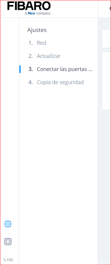

    The Slave Config.
