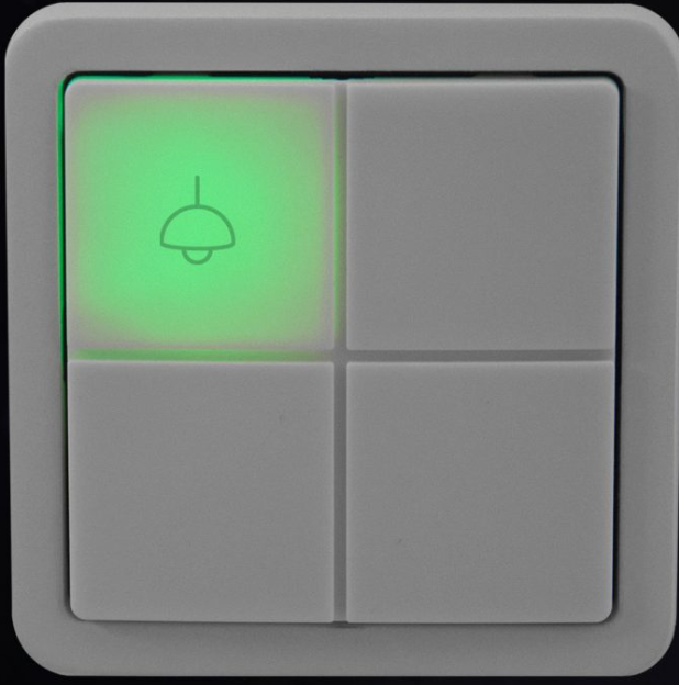

    Im using these contacts - you probably already know ;
    Depending time og day the background light will be Off / week / strong
    Im using rules like $DayControl below to Set the background light
    This is my HTTab - and values below are the 4led in each contact.
    I set the HTTab in a scene - below is a small section of the whole HTTab
    I use your :color function to set the Background light.
    A few of the LED are also used for indication eg. the CO2 level in the living room or if my Alarm is enabled.
    When special setting has been set, how do I add writeprotect for the LED so the special settings wont be overwritten for the $DayControl rules?
    And when Special settings are over, how do i add the right color to the LED based on what $DayControl has gone to ?
    I still want to use the :color so i guess I need a clever way to add and remove the LEDs from the active HTTab ?
