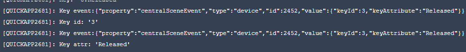

    Yes, but only this way i got it back working. As i have this rule in customer's houses, it is quite crucial for me. They have dozens of remotes,and around 26 blinds..so quite essential to have it working
    A rule like
    should give an output like
    but you don't get id and attr???
    1 minute ago, Neo Andersson said:
    Remote event: #device{id=2452,value={keyAttribute="Pressed",keyId=1},property="centralSceneEvent"}
    This looks ok

    i think the problem is int this part
    Just now, Neo Andersson said:
    No i did not get them
    Jan, is that correct, isnt here something that i should have changed?
    It's the latest version of ER5 also?

    This is really strange so let's try to corner this bug
    and press a button so I can see what happens

    I am still using this below, i dont have anything else
    In engine.lua line 58 there is a function
    change it to
    to see if it's called when you press the button
    Remove that - :key is built in these days and provide more functionality. This could be the cause of the bug...
    I dont get you..I have the latest version of ER5, what should i remove?
    Okay got it, i commented out like below
    /monthly_2023_12/image.png.9fa89546958e9997c49624ad7d5902db.png" />
    Do the same with windowOpened part too?
    After i commented out, it seems to work
    So this SETP(er) is not needed anymore..???
    Good!
    No, WindowOpened is not added so keep it
