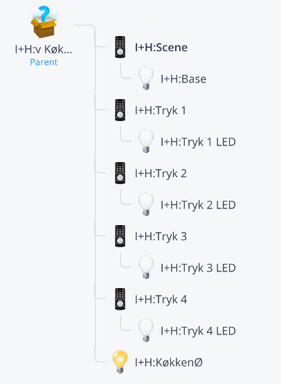

    I using this code
     to filter out all my Matrix Switches.
    Each Matrix got 12 devices and Only 5 devices are interesting at this time
    2,5,7,9,11 - the Scene and the 4 LEDS.
    I have a List like below with 25 Matrix  - can i Filter out in a new list eg 25:    "Led1": 30,     "Led2": 31,  "Led3": 32,     "Led4": 33, from the
