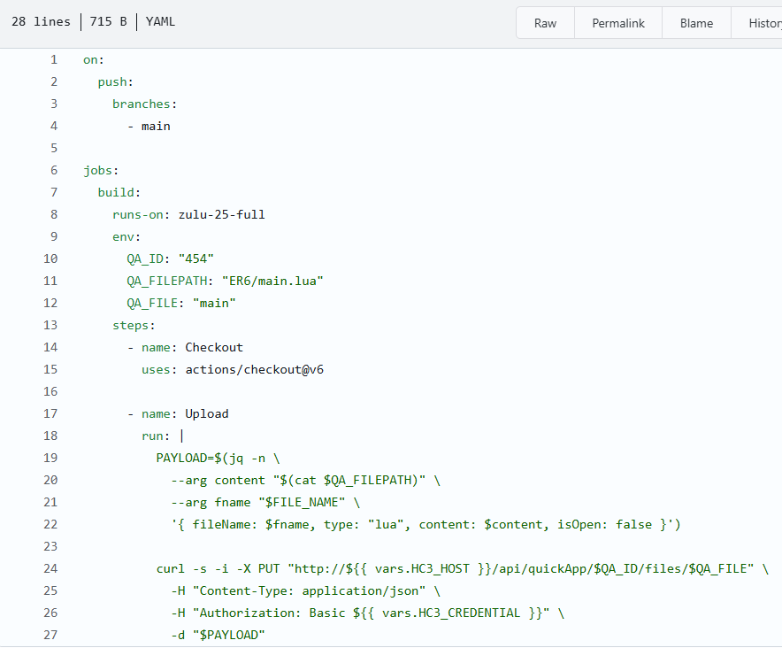

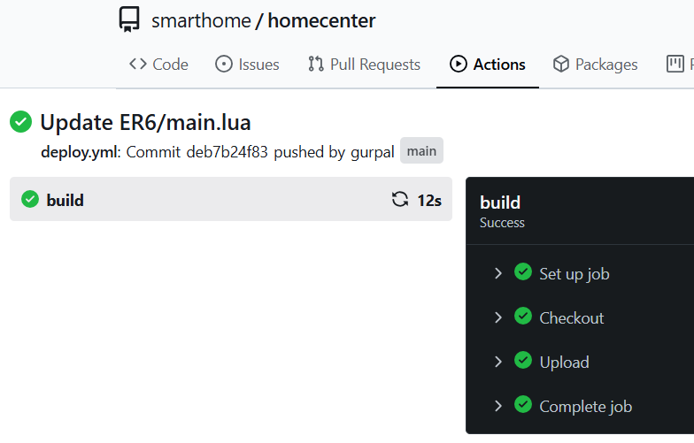

    As per suggestion from @jgab
    , I am just sharing a way to deploy a code/rule change from a self-hosted git (Gitea) using "Github actions", GitOps style. I'm hoping I don't have to explain some of those terms - out of scope.
    I wanted to source control my ER6 code (rules) then deploy them straight to HC3 without opening up the HC web interface. I don't tweak these rules often, but I'd like rest of the family to learn to tweak our automations in their own time. Source controlling allows a review (after an 'release' enhancement TBD) and importantly, rollback in case things go wrong.
    Disclaimers:
    - This is a bare minimum / demo to get things going.
    - Plenty of improvements can be made; best practices should be applied.
    - Not responsible for trashing your QAs.
    - Credentials should be kept in a secret store/vault not variables.
    - Works On My Machine.
    - This is a "push" approach.
    - You could probably get an MCP + LLM to do all this anyway.
    My pre-reqs:
    - HC3 up and running
    - ER6 deployed with QA ID noted
    - ER6 "main" file to be source controlled at least once
    - Gitea installed and can reach HC3 (same subnet, vlan, etc)
    - Gitea Actions already work
    - Gitea Runner has label minimally "zulu-25-full:docker://cimg/openjdk:25.0-node" (i just happen to use this for my other dev work)
    Notes
    - Working out the escaping using native commands was a real pain
    - Learnt a lot and nuances between creating a new file vs updating an existing one (thanks to jgab's MCP and qaDist code)
    - I run most of my home infra on incus+docker+opentofu
    My project layout:
    /monthly_2026_04/image.png.0aace1b25da4c856ef375c9cfb784949.png" />
    main.lua = main below, say
    deploy.yml - example is
    vars like HC3_HOST are variables set globally or at org level within Gitea itself.
    When i commit main.lua, a deploy takes place and in <15 seconds the QA on HC is updated :)
