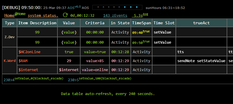

All data displayed  as a table where all configured devices and their related data displayed in human readable format. Extra button 'Refresh' will appear and covers 'Clear' button. Press ‘Refresh’ or ‘Start’ buttons to refresh table data.
Spoiler
Table's header includes:
Spoiler
startup time stamp, script current version, scene Name, LED as displayed at HC2 front panel, sunrise/set hours.
System name – by hovering mouse over, system inventory shown
Spoiler
Current home mode (@home or @vacation)
system status - by hovering mouse over,  last system's activities is shown
Spoiler
Elapsed time
Total Z-wave events - by hovering mouse over summary of all activities shown
Spoiler
Min, average and max Z-traffic, by hovering mouse over CPU elapsed time shown
Spoiler
By hovering mouse over column headers, quick guide is shown. Quick guide displayed during 5 minutes from startup. On every manual refresh, the guide displayed for next 5 minutes.
Spoiler
Table columns are:
Type – device type (Z.Device, G. Variable, V.Device, luaScene, blockScene, magicScene, Auto-luaScene, Auto-blockScene, Auto-magicScene). By hovering mouse over Z.dev type column, top active devices are shown. User configurable by setting topActive global variable. (0-30) default 15
Spoiler
ID: Description – room name: device ID: device name. Z-wave devices sorted by rooms, then by device ID.
Battery capable device have green background according to current battery level. If device armed, alarm icon appears.By hovering mouse over, inventory of devices in jM{} table are shown.
Spoiler
Value – items current value. By hovering mouse over, latest values, trigger value and command executed are shown.
Spoiler
Criteria – state of evaluation to determine true or false status. If formula included, the state displayed in Italic fonts and by hovering mouse over, popup menu shows the formula and calculations
Spoiler
Last seen – elapsed time since last status change.
Alert – by default this column isn’t shown. If any devices have been alerted the column will be shown. Please notice that in some cases the device could be alerted, but after while it could back to normal activity. For example, if motion sensor is breached over specified time-span, alert notification will be sent. But after a while the sensor back to safe and alert is canceled, “back to normal” notification will be sent.  At header of alert column shown current number of alerts
Spoiler
Time Span – time span to monitor state of items. By hovering mouse over, maximum reached span time shown.
If time span set to 0, then this line acts as activity, no timeout alerts reported.
If time span set to negative number, this line is suspended and no actions executed.
Spoiler
Time Slot – Active time slot range to execute related actions. Timestamp to execute specific action at specific time.
trueAct – list of actions to execute when state is true.
falseAct – list of actions to execute when state is true.
trigAct – list of actions when value changes
timeoutAct – list of actions to execute when time-span reached.  Timer will be restarted when device state changed again to true.
timeLoopAct – list of actions to execute when time-span reached.  Timer restarted if state still true (no state changes required)

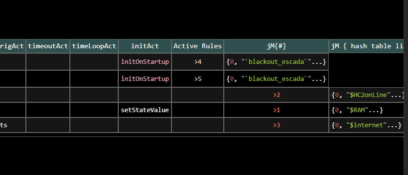

initAct – list of actions to execute when scene started.
Spoiler
    By hovering mouse on actions cells, action’s details are shown
Spoiler
In shown example for trueAct{} actions:
a) time span of irrigation system calculated on line according to ambient temperature. min(max(floor(@47>value)-25,0)+10,18)
b) TTS message announced (Garden Dripper has started)
c) Irrigation is turned ON.
The entire execution process is shown including all calculations, so user could see what exactly will happened.
VacMode – vacation mode.  In vacation mode by default timeSpan ignored and all Z-wave devices are converted to Activities, Scenes and VDs are not monitored.  Non default vacation state could be defined in each line (vacation=”normal” or “stop”).
Device index in jM{} hash table  – shows device location in jM{} hash table. By hovering mouse over cells, device description, manufacturer, zwave version and JM{} line shown.
Spoiler
At the bottom of the table list of up to 60 last executed actions (in order of execution) is displayed. (like CNN news line). If the device has same state as required by command, command isn’t executed and colored pink.
Spoiler
Table color code:
1. Value, Criteria and Last seen columns
 green – state is true
 pink – state is false
 yellow – out of defined time slot, no actions or monitoring done.
  gray – line suspended. To suspend the line, set time-span to negative value.
 red -  in alert-state, means this line exceeds time-span and auto-alert sent.
2. Time Slot
black background and Suspended/Disabled label in gray means this line is inactive.
Gray background and Activity label in green means the device assigned to control only. (Time span  is zero).
   green background and red progress bar, device is monitored. On timeout auto-alert sent.
blue background and purple progress bar, device is monitored and on timeout actions executed. (No alerts)
Spoiler

And something seems to be not aligned in this monitor table...
Is it normal?
TMF
Is it normal?
The item description is, in fact, the actual value... something seems wrong :/
cag014
