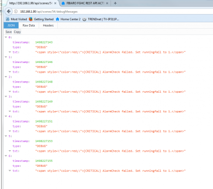

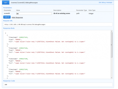

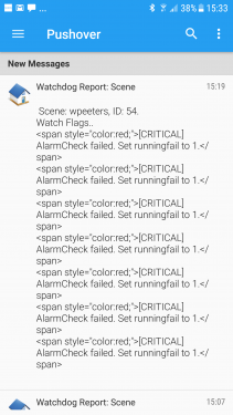

    HI @AutoFrank, thanks for the VD. It's very welcom while migration all my HCL scenes to HC2 Lua scenes.
    Is it possible there is a problem for reporting the 'watch flags' in a mail if the string was only found once in a scene?
    See below screenshots. For 1 it is working if it occurs frequently. The other one, where it is only once in the debug, the watch flags are not reported.
    Strings to search for are 'CRITICAL' and 'MAJOR'. The white screen below the debug window is the content of the mail.

    I'm not saying this is your issue, but I'm surprised by the number of backslashes...
    @petergebruers. yes, I noticed them as well but I have no idea why.
    This is my debug setup:
    local debug = false --set to false to stop debug messages --> log
    local logInfo = true --set to false to stop debug messages --> info
    function log(color, message) if debug then fibaro:debug(string.format('<%s style="color:%s;">%s</%s>', "span", color, message, "span"));  end; end
    function info(color, message) if logInfo then fibaro:debug(string.format('<%s style="color:%s;">%s</%s>', "span", color, message, "span"));  end; end

    With regard to the backslashes - thats an odd one and something to do with the way the message the contains html formatting is sent by the HC2 email server
    I tried a few experiments
    If I use this in a scene
    then the result over email is
    and it doesn't matter if it gmail or private email
    Now if I execute this in a scene (which is equivalent to your function code)
    and run it 6 times
    Then I received this in email
    yet if I look at it through /docs I get the expected html tags and the same with a browsers api call
    Pushover seem to interpret the html better as the result is
    In summary I fixed the bug (thanks for finding) but I don't have a solution to the unusual tags seen over email
