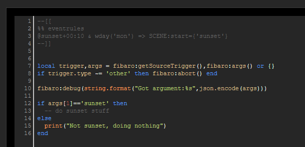

    Another cool hack one can do is to use EventRunner as a very flexible scheduler for standard H2C scenes.
    Create an EventRunner scene with the following main():
    When that scenes starts up it will look through all scenes on the HC2 and their headers, if it sees a scene looking like this:
    If there is a "%% eventrules" header it will take the eventscript rules declared afterward and evaluate them. 'SCENE' is replaced with the scenes id, and if there is no "=>" in the eventscript it will add " => SCENE:start" at the end of the rule.
    This means that this scene will be started at 10:00 every day, and at sunset+10min every Saturday. In the latter case it gets the argument {'sunset'} too.
    A very simple way to write scenes that should be scheduled at various times and under different conditions.
    The only trick is that the EventRunner scene needs to be restarted when a scene's header is changed so that it will reparse the scene headers and set up the new rules.

    @jgab, not sure your "hack" is working, at least not for me. Not writing out the rule in mainscene.
    /monthly_2019_01/eventrunner.png.02223da89e2396fb4858e1e3282b84c7.png" alt="eventrunner.png.02223da89e2396fb4858e1e3282b84c7.png" />20190121_07-00-25.png.0c59e9e19e2d1b3de8835f057f41557f.png
    Thanks, of course there were bugs. I edited the post.
