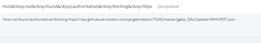

    @jgab Jan, QA updater in cusmter's house is throwing erros, it was working, and i naver touched it
    /monthly_2024_03/image.png.e2c66d9a5e4ca64843a93b9f15b6a06c.png" />
    Okay, after refresh, it seems to work..There was a system restart, and after that QA updater threw those errors
    Seems like your box didn't temporarily) have internet/dns connection to connect to github where the QAUpdater manifest is stored (info about QA versions and updates)
