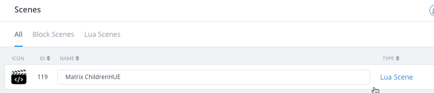

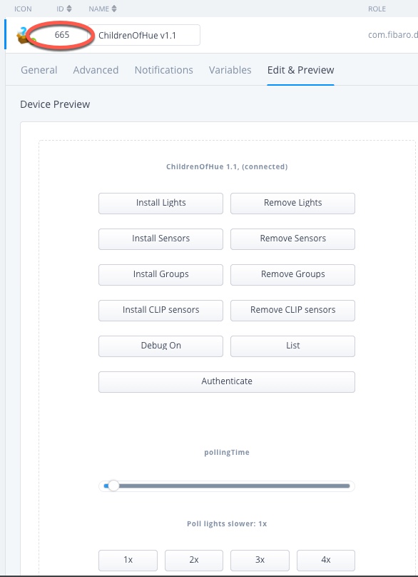

    I Home :-) trying to implement Children og HUE with Matrix
    No Success Yet.
    MY Scene ID is 119182383769_02SceneID.jpg.238ff05f5dd9e4cbc8932aff74e3f409.jpg
    Children of HUE is version 1.1 and its connected
    The Code and My Matrix is 666
    My Children of Hue Bulb ID is 687
    My history should document data is transfered.
    The is NO reaction to the Bulb at all.
    Manual Bulb Control works
    Any Idea ?

    What type id the 687? is it a com.fibaro.multilevelSwitch?
    I will check the HueDevice code later this evening to see if I can find anything strange there.
