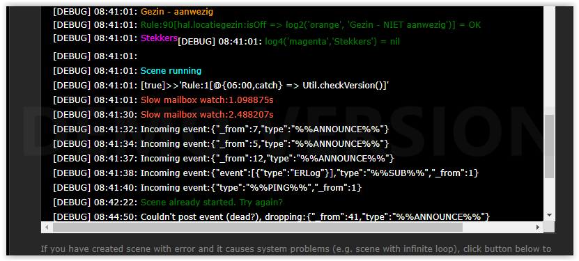

All scenes stopped again last night.
Supervisor scene fresh copy  same result. What is happening I have no idea but for me it looks Supervisor over floods the scene(s) to restart?
/monthly_2020_07/image.png.e60edff632c481fff1301550d9b09564.png" />
Hal scene runs 8 instances it wants to start again then it stopped  (Supervisor?)
I stopped Supervisor 08:55 All scenes are running on one instance.I will leave it as it is now to see when a scene is stopping.
What to do?
Thanks for your support
//Sjakie

    Hi, as I recall from the past you have these strange long delays in your system now and then... I guess things can get bad then.
    Anyway,
    In supervisor have you set simplekeepalive to true?
    and later in the file you can increase restarts to 4
    I will look a @petrkl12 patch and see if it can help. Thanks.

    Slow mailbox can be due to high cpu but it can also be due to the HC2 decides to "do something else" so the scene is not scheduled in time by the "operating system".
    It could also be due to that here is some rule/code in the ER scene that hangs on doing something. The latter I don't know what it could be. I can understand ~1s delay due to many rules but in your log it show ~10.3s delay where the main loop in ER gets no time(!) That's exceptional and I have a hard time finding a good explanation.
    In theory, if all your scenes worked well, you should not need the Supervisor I guess.
    When we move over to the HC3 the Supervisor will not be needed to restart WAs as they do it themselves.
