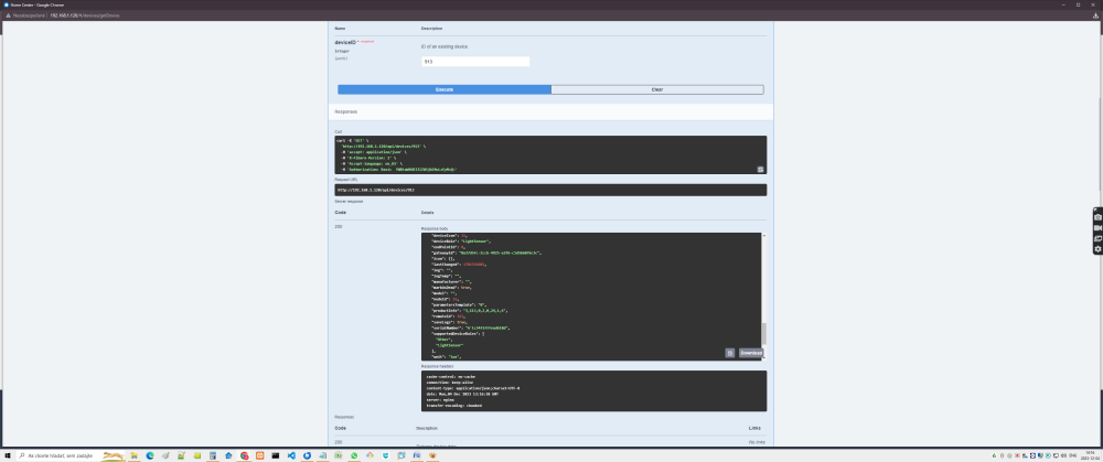

    Hi jgap
    Thanks for your update
    I have another problem
    The rule is this
    Rule.load([[
    -- fibaro swipe
    831:central.keyId=='1'  => log('Key 1 pressed')
    831:central.keyId=='2'  =>  log('Key 2 pressed')
    831:central.keyId=='3'  => httpGet('http://12.10.79.115/apps/api/1484/devices/1831/open?access_token=a421fe15-5f3a-466b-a039-ea13a9272f1f'); log('Key 3 pressed'
    831:central.keyId=='4'  => httpGet('http://12.10.79.115/apps/api/1484/devices/1831/close?access_token=a421fe15-5f3a-466b-a039-ea13a9272f1f'); log('Key 4 pressed')]])

    Is it your own provided httpGet function? Can you post the definition?
    Hi gap
    I got it from er3
    under
    function httpGet(url)
      local http = net.HTTPClient()
      http:request(url, {
          options = { method = 'GET' },
          success =function() fibaro:debug(url.." ,done."end,
          error = function(errorcode) fibaro:debug("error=" .. errorcode) end
