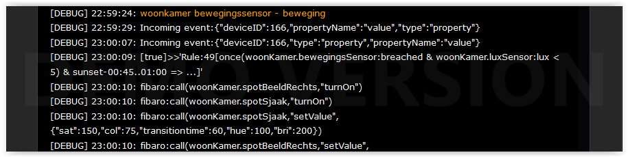

    One thing I dont understand if I switch on a few lights it gives in debug with color posting lamp is On.
    If I switch spotSjaak on it will start the yellow color in debug.
    Is that because spotSjaak is as last in the row of HUE,monitor?
    Rule.eval("Hue.monitor(woonKamer.spotBeeldLinks,1000)")
    Rule.eval("Hue.monitor(woonKamer.lampPlafondTvZijde,1000)")
    Rule.eval("Hue.monitor(woonKamer.spotSjaak,1000)")
    When I add this also to another scene with off course other names it will continuous loop the hue api
    Please advice,
    //Sjaak
