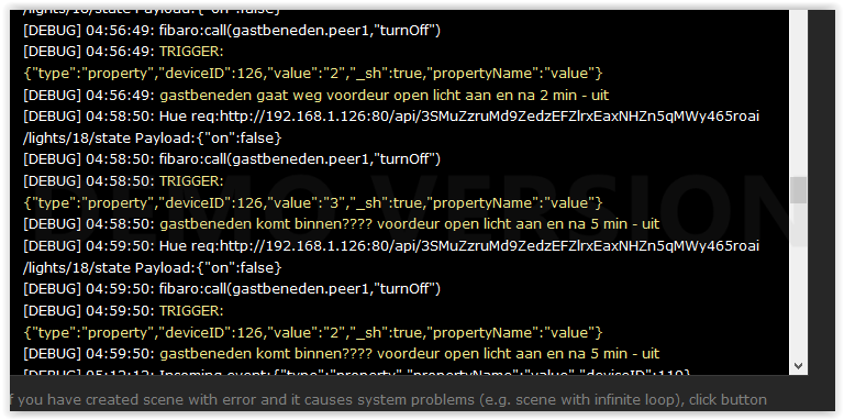

    Jan,
    This one is giving me headache I cant find whats wrong.
    Door hast been open for two days still rule is executing?
    Util.defTriggerVar("openfromInsideDoor",false)
    rule([[gastbeneden.door:breached =>
        || trueFor(00:02, voortuin.motionsensor:safe) >> openfromInsideDoor=true
        || voortuin.motionsensor:breached >> openfromInsideDoor=false
    rule("openfromInsideDoor==true & 15:00..17:00 => log('TRIGGER:%s',tjson(env.event)); log('gastbeneden - present'); post(#gastbenedenPresent)")
        Rule.eval([[#gastbenedenPresent & @17:00 =>
            1833:start
    rule("openfromInsideDoor==false & 13:00..17:15 => log('TRIGGER:%s',tjson(env.event)); log('gastbeneden afwezig'); 1833:start")
    rule("openfromInsideDoor==false  & sunset-00:30..sunrise+00:30 | voortuin.luxsensor:lux < 350 => gastbeneden.peer1:on; gastbeneden.peer1:value={bri=255, transitiontime=80, col=200}; wait(00:05:01); gastbeneden.peer1:off; log('TRIGGER:%s',tjson(env.event)); log('gastbeneden komt binnen???? voordeur open licht aan en na 5 min - uit')")
    rule("openfromInsideDoor==true & sunset-00:30..sunrise+00:30 | voortuin.luxsensor:lux < 350 => gastbeneden.peer1:on; gastbeneden.peer1:value={bri=150, transitiontime=400, col=200}; wait(00:02:00); gastbeneden.peer1:off; log('TRIGGER:%s',tjson(env.event)); log('gastbeneden gaat weg voordeur open licht aan en na 2 min - uit')")
    Please advice,
    //Sjakie

    Couple of quick comments without having tested the rule.
    You can't have trueFor in
    trueFor can only be used in the left hand side of '=>'
    will not trigger on #gastbenedenPresent, but only at 17:00
    The last 2 rules suffer from the '|' problem discussed in the previous post. Add paranthesis where needed.
