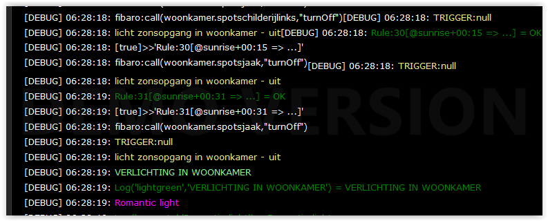

Good morning Jan,
What is wrong?
/monthly_2019_12/image.png.0e76c08fea0cd3c4440a3611f1508a1d.png" />
Not yet Sunrise but debug shows
Rule30 and 31 is true and its executed
Please advice,
//Sjakie

    On 12/2/2019 at 6:53 AM, Sjakie said:
    Good morning Jan,
    What is wrong?
    Please advice,
    //Sjakie
    Do you have a .start() added at the end of the rule?
    Can you show me the whole rule definition that starts with @sunrise+00:15 => ...
    Jan,
    Thanks you are the best.
    Sorry, .start() removed.
    //Sjakie

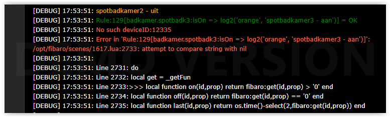

    Hello Jan,
    I dont get this badkamer.spotbadk3 = 12335 (data from HT{badkamer= spotbadk3=12335,)
    /monthly_2019_12/image.png.31c279bf4d341572cd727d0fa9c40069.png" />
    12335 doest excist?
    In HUE app spotbadk3
    Where do I miss what?
    Please advice,
    //Sjakie
    On 12/9/2019 at 6:10 PM, Sjakie said:
    Hello Jan,
    12335 doest excist?
    Please advice,
    //Sjakie
    It looks like 12335 is not defined. You have not done Hue.define("name of hue device",12335).
    That why it complains "No such devideID:12335".
    Morning Jan,
    You are right!
    Overlooked the HUE define contained an error in the number.
    Thanks,
    //Sjakie
