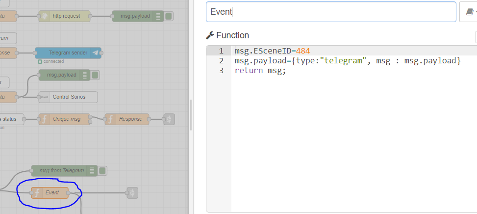

    Here is code i use in a separated scene for Telegram. I can send for example "set testvar to test1234" and get a response back.
    put inside main()
    remember to set sceneID in NR
    6 minutes ago, jompa68 said:
    Good :)
    put inside main()
    or msg.ESceneID=-1 if you want to send to the PC while testing. You also need to setup the ZBS node with the ip and port of the PC (6872)
