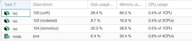

    I can recommend run Proxmox VE , it is a open source virtualization platform. I have setup 3 different linux containers with different purposes, one of the containers is where i have installed node-red.
    I run backup every night to my nas so it easy to recover if needed.

    Haha, i read everything that are posted here, so i have not been away. I am so satisfied with ER, running very fine without any interruptions now.
    I run it on a small HP EliteDesk 800 35 W G4, you can see total memory and cpu usage for all my 3 containers if you look at node (pve)
