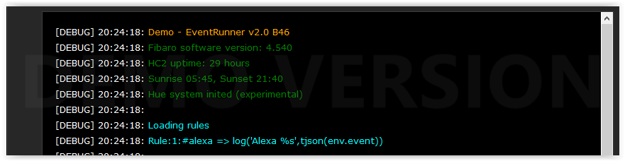

    In that ER scene on the HC2 add the rule
    Then in the node-red flow, click on the grey-blue "Test" node (or the square just to the left of the node) that will send an event to your ER scene.
    It will be of type #alexa and print out the whole event in the ER log on the  the HC2.
    If you get that up and running we can start make the other stuff work.
    Note that the "sonosTTS" node require some setup on Amazon AWS (it's free but a bit involved).
    wow thankss,
    Yep it has send the payload.I have tried it a few days now without any positive result. Thank you very much I appreciate your time and effort.

    @jgab I have never used Node Red, so I have followed your instructions to @Sjakie with great interest. Got Pollysonostts, alexa and echo working in your flow that you showed earlier. But i have problems with telegram. I did send 'turn on kitchen lamp' and received:
    Sat/May/25,14:58:35:[20:1] Rule:1:#telegram{msg='$msg'} => cmd=msg.content; log('Telegram command:%s',cmd);
    Sat/May/25,14:58:35:[20:1] Scene running
    Sat/May/25,14:58:35:[HC2 ] System trigger:{"type":"other"} to scene:20 at Sat May 25 14:58:35
    Sat/May/25,14:59:51:[20:1] Invoking:#telegram{msg='$msg'} => cmd=msg.content; log('Telegram command:%s',cmd);
               || str=matchCommand(cmd) >> telegram(msg,str)
               || true >> telegram(msg,frm("Sorry, didn't understand '%s'",cmd))
    Sat/May/25,14:59:51:[20:1] [{"type":"telegram","msg":"$msg"}]>>'#telegram{msg='$msg'} => cmd=msg.content; log('Telegram command:%s',cmd);
    Sat/May/25,14:59:51:[20:1] Telegram command:turn on
    Sat/May/25,14:59:51:[20:1] System trigger:{"type":"property","deviceID":401,"propertyName":"value"} at Sat May 25 14:59:51
    Sat/May/25,14:59:51:[20:1] fibaro:call(hjelpfunktioner.margarethas_keyfob,"turnOn")
    Sat/May/25,14:59:51:[20:1] Error in '#telegram{msg='$msg'} => cmd=msg.content; log('Telegram command:%s',cmd);
           ': undefined fun 'telegram'
    Program stopped (pid: 32088).
    Debugging session completed (traced 0 instructions).
    Program completed in 79.92 seconds (pid: 32088).
    Where does deviceID 401 come from and what is   ': undefined fun 'telegram' ? Thanks for your help.
