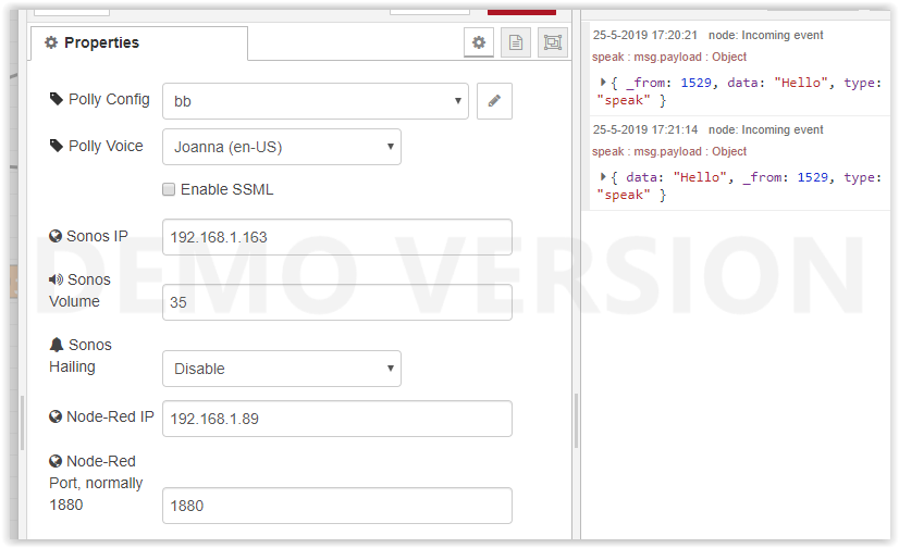

    Hello again,
    I was lost with Polly also because I had a test flow on >>that was giving sound to my Sonos speaker. With several Polly.config files.
    Hehe sorted that out and sorry to be a pain in the rear end because Frankt did it also with your guidance.
    Now I have stereo sound, hello from the laptop and a whistle with hello from Sonos, so I am a big step forwards.
    Dont have any clue why the sound is also send to my lappie 192.168.1.5
    In the NodeRed flow only ZBS is having 192.168.1.5:6872
    Please advice
    As par instruction:
    /monthly_2019_05/image.png.e50ec1e4eb11d68e70e3b92c3bfc9dad.png" alt="image.png.e50ec1e4eb11d68e70e3b92c3bfc9dad.png" />
    1 hour ago, Sjakie said:
    Hello again,
    Ok, progress! :-)
    Do you have a wire to the node named "Talk" located under the node "sonospollytts". The talk node speaks through the speaker on the laptop that has the node-red GUI open.
    You are the best great it works!!!
    I noticed a difference in volume it is the same scene:
      Rule.eval("#speak{text='$text'} => remote(_myNodeRed,#speak{data=text,volume='75'})") -- create event handler
     (to add in every scene where you want to us Polly)
      Rule.eval("remote(_myNodeRed,#speak{data='Hallo, wat ben je aan het doen? '})")
     Volume as set in Node Red SonospollyTTS >>>>25 I should expect also 75
      Rule.eval("woonkamer.bewegingssensor:breached => log('TRIGGER:%s',tjson(env.event)) ; post(#speak{text='Hallo Arleta ben je al  gereed met je karweitje?!'})")
    Volume 75<<<<<<<<<<<<<<<<<<<
    Thanks for your support excellence!!!

    So the #speak handler sets the volume to 75
    If you just call  Rule.eval("remote(_myNodeRed,#speak{data='Hallo, wat ben je aan het doen? '})") I would expect the default 25 (that is set in the node-red config of the node. It could be that it uses the last set volume too, I'm a bit unsure.
    You can make the handler I provided a bit more flexible by accepting an optional volume parameter or default to, like 50
    Then you can do
    Thanks,
    Correct defaut volume setting in NodeRed.
    Have nice weekend
