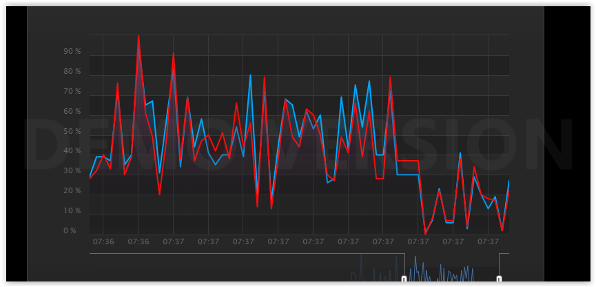

    @Sjakie your CPU load looks really high. My average is around 30% during 5min.
    I run 6 ER scenes now without any problems. Could it be some other problems? Earlier i did see some picture from your post that deviceID in your HC2 was high, more than 1500 or so. Perhaps the database is corrupt?
    Perhaps you should create a ticket to fibaro support to see if they find some strange setup of your box
    6.23.03 Supervisor freeze
    6.24.00 start 4th scene
    6.26.44 restart 4th scene scen was NOT stopped
    6.30.39 start 5th scene
    supervisor freezes 2 minutes
    6.33.47 start 6th scene

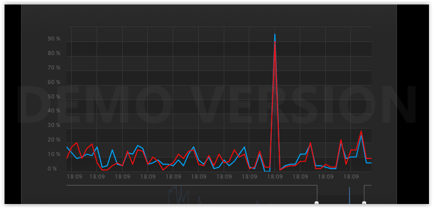

    Hi Jompa,
    Device ID looks normal
    with scenes I am in 1500
    07.10 Scene woonkamer is generating the most traffic>>> switched off
              All older scenes of ER deleted ( I dont think they will consume but supervisor will ping them)
              I watched it 5 minutes and the picture looks very nice
             Sometimes a peak 70%
    Supervisor is still missing sometimes 1-2 minutes with this low load
