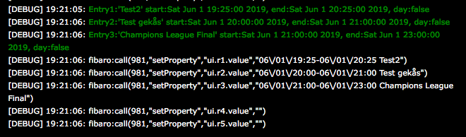

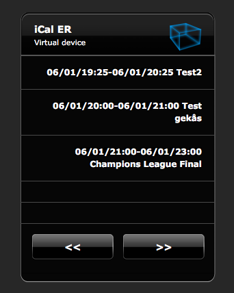

    Got it now :D
    125420877_Skrmavbild2019-06-01kl_19_21_50.png.f02aa081bb8d6631bc513db727a2d7d4.png516450840_Skrmavbild2019-06-01kl_19_22_00.png.b98d1a7135d7524c87acdf1af77f81b6.png
    3 hours ago, jompa68 said:
    Got it now :D
    So, how can we improve it? Better formatting of entries? New functionality?

    New version of iCal.lua (B6)
    Added an update button to VD.
    More compact date format in VD.
    Previous example with ER commands in description is updated (fixed parsing of new lines and description field containing ':')
