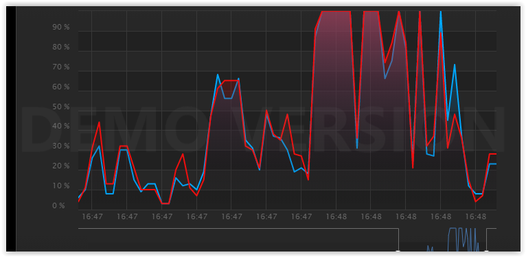

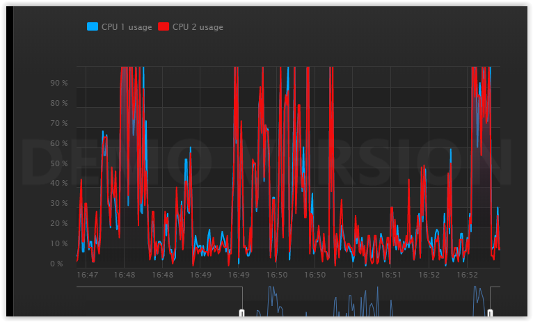

    The cpu load is lower as before I started 70-100%. According Zwave monitor:
    /monthly_2019_05/image.png.fd88e8acef86384c0904c12873e19a4a.png" alt="image.png.fd88e8acef86384c0904c12873e19a4a.png" />
    It will go also sometimes to 100%
    27% used 14% cached 2% buffer 57 % free
    6 ER scenes , 1 supervisor, 2 lua scenes security, homeTable, and 6 GV scenes
    I will  wait for your advice

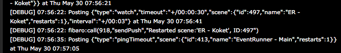

    Ops, that handler have disappeared...
    Try to add (will include in next version)
    scene is a table; {id=<sceneID>, name=<sceneName>, restarts=<times scene have been restarted>}
    Working :)
