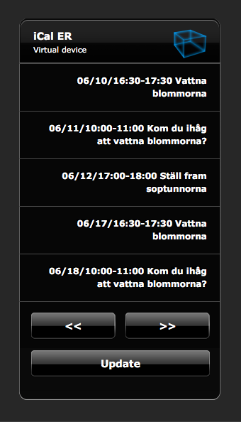

    Why is it missing this weeks entries?
    /monthly_2019_06/image.png.4542050e085f48e2fa98a2edf7843577.png" alt="image.png.4542050e085f48e2fa98a2edf7843577.png" />
    Strange, haven't seen that behavior. Does iCal.lua log all the events? iCal.lua only tries to fetch events after the current time/date but it looks like it's skipping days... or is it just the VD that has problem?
    Will have a look when I'm back home.
    Same behavior on iCal.lua. Skipping this weeks entries.

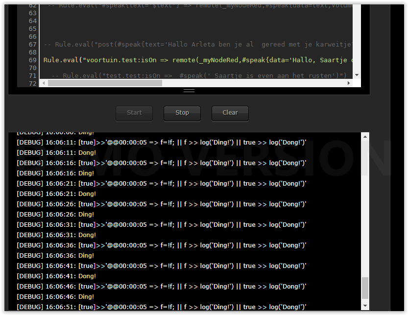

    Hello Jan,
    When I activate voortuin.test:isOn  or manual or in the sytem it is not listed in the debug window of the ER sceneso no action. Debug for rules and rulesfalse is true.
    voortuin.test is listed in the header (96) What I overlook?
    Please advice

    11 minutes ago, Sjakie said:
    Hello Jan,
    Please advice
    Can you send me the scene an I can have a look at it.
    Hereby,

    Hello Jan,
    I activated 96 about 14 times before send you the message.
    Imade a copy for you and now I activated 96 and its signal came
    /monthly_2019_06/image.png.962594aa7ae29a1bf2d0e25e41363d22.png" alt="image.png.962594aa7ae29a1bf2d0e25e41363d22.png" />
    I think the date is 1 week wrong when adding a reoccurring entry, see my calendar and VD(same info in ical.lua)
    Yes, there were a bug in recurring events, fixed the, pushed vB8.
