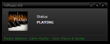

    Hi API users,
    Something new for you.
    Do you ever wish that you could display the radio station of that line in selection instead of the plain static icon of a music symbol or a sonos player.
    Well now you can ... :D
    sonos-blu.PNG.73d6d461070fa035fcb938e2f8051112.PNG sonos-calm.PNG.6d272533b99b674ff63dec472001214c.PNG
    It also looks equally well on your phone or viewing the VD controls in the WEB UI
    Here we go..... There is a little work with this one as you need to create and upload some icons but not too much if you use @Sankotronic recent icon viewer VD and GIMP to make/steal borrow the icons
    I'd put this at a medium difficulty, you will probably need an hour and 2 cups of coffee :D
    The code is two tables and two if loops to figure out the correct icon to display. This goes into the main loop of the VD that you are running at the moment
    (I'll upload the VD I used to develop and test this bit of code for a complete solution)

    Some more screenshots
    Line in
    sonos-blu.PNG.d89263cb22fe894a574e6f36ab33c070.PNGsono-satTV.PNG.16fc925710bfe104d9f0ce624af9fd81.PNG
    sonos-droid.PNG.51f9bb61ca899263149209f6d8a03d63.PNGsonos-bt.PNG.09cecea58a59f841c118f8949a3115ac.PNG
    Radio
    sonos-calm.PNG.6d272533b99b674ff63dec472001214c.PNGsonos-4fm.PNG.b2b980730efae13b8708e206bede3d63.PNG
    sonos-96fm.PNG.91f093e563ff84d5ade621f454fa1e2d.PNGsonos-heart.PNG.2bfaa510228170f0086a8365f5ae94b2.PNG
    VD from the web UI
