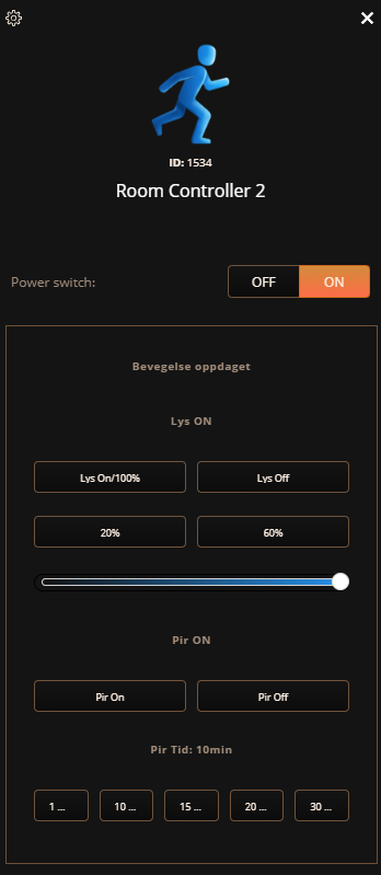

    Hi @jgab. I have tried to use your Devicesensor.fqa to make a "Room Controller" as i call it. The Devicesensor solved the problem with scenes with delays not always triggering for me :D
    the problem I am having now is that I cant get the QA to trigger functions like the Scenes does.
    For example when the power switch goes on AND the variable "statusPir" is on (pir on and pir off sets the variable on/off)
    I want the LightsID to be triggered with the number from "OldStatusLys" (last active state)
    I also dont understand how I can retrive the self variables and use them to "setvalue"  😅 hoping someone can help me 😅
    Here is the code:
    _=loadfile and loadfile("TQAE.lua"){
    refreshStates=true,
    debug = {
        onAction=true, http=false, UIEevent=true, trigger=true
    offline=true,
    --%%name="Room Controller 2"
    --%%noterminate=true
    --%%quickVars={Lights=1,delay=1,StatusPir=1,StatusLys=1,OldStatusLys=1}
    --%%u1={label='info6',text="Bevegelse oppdaget"}
    --%%u2={label='info1',text="Lys"}
    --%%u3={{button='b1',text="Lys On/100%", f="lyson"},{button='b2',text="Lys Off", f="lysOff"}}
    --%%u4={{button='b10',text="20%", f="Dim20"},{button='b11',text="60%", f="Dim60"}}
    --%%u5={slider='Dim',value="50", f="Dim"}
    --%%u6={label='info3',text="Pir on/off"}
    --%%u7={{button='b3',text="Pir On", f="PirOn"},{button='b4',text="Pir Off", f="PirOff"}}
    --%%u8={label='info5',text="Pir Tid"}
    --%%u9={{button='b5',text="1 Min", f="Min1"},{button='b6',text="10 Min", f="Min10"},{button='b7',text="15 Min", f="Min15"},{button='b8',text="20 Min", f="Min20"},{button='b9',text="30 Min", f="Min30"}}
    PirOn="Pir ON"
    PirOff="Pir OFF"
    LightOn="Lys ON"
    LightOff="Lys OFF"
    local LightID={493,489,628,629}     --nattbord høyre silje 493    nattbord venstre 489 joppe   628 og 629 tak sov
    local interval = 1
    local devices = {}
    local delay = 0*60
    local isOn = false
    local format = string.format
    local function valueOf(v) return type(v)=='number' and v > 0 or v end
    local function checkDevices(self,devices)
      local on,last = false,-1
      for _,in ipairs(devices) do
        local value = api.get("/devices/"..d.deviceId.."/properties/value")
        if value then
          d.value = valueOf(value.value)
          d.last = value.modified or os.time()
          on = on or d.value
          last = math.max(last,d.last)
      last = os.time()-last
      if last < delay and not on then -- not off long enough
        self:updateView("info","text",format("Delay %ds (%ds)",delay,last))
        return
      if on ~= isOn then
        self:updateView("info","text",format("Delay %ds (%ds)",delay,delay))
        isOn = on
        self:updateProperty("value",on)
        self:updateProperty("state",on)
    function QuickApp:onInit()
      self:debug(self.name, " deviceId:",self.id)
      self:updateView("info1","text",""..LightOn)
      self:updateView("info2","text","Dim")
      self:updateView("info3","text",""..PirOn)
      self:updateView("info4","text","Pir Tid")
      --fibaro.call(plugin.mainDeviceId, "setVariable", "LightID", "...")
      self:updateView("name","text",self.name)
      deviceStr = self:getVariable("devices")
      self:updateView("devices","text","Device:"..deviceStr)
      delay = self:getVariable("delay")
      delay = tonumber(delay) or 0
      deviceStr:gsub("%d+", function(device)
          local value = api.get("/devices/"..device.."/properties/value")
          if value then
            devices[#devices+1]={
              deviceId=tonumber(device),
              last = value.modified or os.time(),
              self:debug(self.name,self.id)
        end)
      if #devices == 0 then
        self:debug("No devices configured. Please set quickApp variable 'devices' with list of devices")
        self:setVariable("devices", "")
        fibaro.call(plugin.mainDeviceId, "setVariable", "Lights", "...")
        --self:setVariable("delay", "")
        --self:setVariable('StatusPir',"")
        --self:setVariable('StatusLys',"")
      self:updateProperty("value",false)
      self:updateProperty("state",false)
      setInterval(function() checkDevices(self,devices) end,1000*interval)
    function QuickApp:turnOn()
        self:debug("Pir PÅ")
        self:updateProperty("value", true)
        self:updateView("info6", "text", "Bevegelse oppdaget")
    function QuickApp:turnOff()
        self:debug("Pir AV")
        self:updateProperty("value", false)
        self:updateView("info6", "text", "Ingen Bevegelse")
    function QuickApp:lyson()
      self:debug("lys på")
      self:updateView("info1", "text", ""..LightOn)
      hub.call(LightID, 'setValue',100)
      self:setVariable('StatusLys',"100")
      self:updateView("Dim", "value", "100")
      self:setVariable('OldStatusLys',"100")
    function QuickApp:lysOff()
      self:debug("lys av")
      self:updateView("info1", "text", ""..LightOff)
      hub.call(LightID, 'turnOff')
      self:setVariable('StatusLys',"0")
      self:updateView("Dim", "value", "0")
    function QuickApp:Dim(ev)
      self:debug("Lys Nivå:",ev.values[1])
    hub.call(LightID, 'setValue',ev.values[1])
    self:setVariable('StatusLys',ev.values[1])
    self:setVariable('OldStatusLys',ev.values[1])
    function QuickApp:PirOn()
      self:debug("Pir På")
      self:updateView("info3", "text", ""..PirOn)
      self:setVariable('StatusPir',"On")
    function QuickApp:PirOff()
      self:debug("Pir Av")
      self:updateView("info3", "text", ""..PirOff)
      self:setVariable('StatusPir',"Off")
    function QuickApp:Dim20()
      self:debug("Dim20%")
      hub.call(LightID, 'setValue',20)
      self:updateView("Dim", "value", "20")
      self:setVariable('StatusLys',"20")
      self:setVariable('OldStatusLys',"20")
    function QuickApp:Dim60()
      self:debug("Dim60%")
      hub.call(LightID, 'setValue',60)
      self:updateView("Dim", "value", "60")
      self:setVariable('StatusLys',"60")
      self:setVariable('OldStatusLys',"60")
    function QuickApp:Min30()
      self:debug("30min")
      self:setVariable('delay',"1800")
      self:updateView("info5", "text", "Pir Tid: 30min")
    function QuickApp:Min20()
      self:debug("20min")
      self:setVariable('delay',"1200")
      self:updateView("info5", "text", "Pir Tid: 20min")
    function QuickApp:Min15()
      self:debug("15min")
      self:setVariable('delay',"900")
      self:updateView("info5", "text", "Pir Tid: 15min")
    function QuickApp:Min10()
      self:debug("10min")
      self:setVariable('delay',"600")
      self:updateView("info5", "text", "Pir Tid: 10min")
    function QuickApp:Min1()
      self:debug("1min")
      self:setVariable('delay',"60")
      self:updateView("info5", "text", "Pir Tid: 1min")
