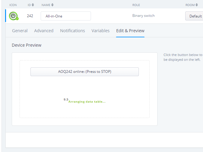

    7 hours ago, SmartLifeSystems said:
    Hi @cag014!
    What do you think? This AOQ working on HC3 Lite?
    Doesn't work
    /monthly_2021_03/457921781_3-1.PNG.ff2c7dc95fac8b69edc29eca0df2321d.PNG" />1924781106_3.PNG.9fc1719099ea5e1e2853a3e8543744a9.PNG1924781106_3.PNG.9fc1719099ea5e1e2853a3e8543744a9.PNG
    12 hours ago, minsad79 said:
    Doesn't work
    You are use the HC3 Lite Slave or Master?
    23 hours ago, SmartLifeSystems said:
    Hi @cag014!
    Yes, it does... I made required changes and it does run on my HC3 lite
    I mean version 9.7 and later  I released here.
    AOQ version 9.5 doesn't support HC3 lite.
    Will release updated version at download center soon.
