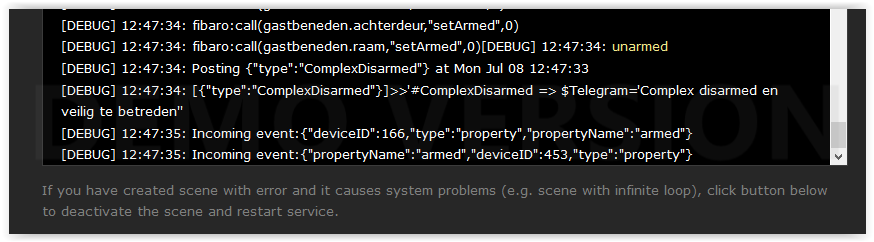

    If I proper understand when the "buglar"moves it will trigger motion sensor and will start cyclus AlarmstateOn again?
    So a part of the loop was me! I am sitting in the living>>>omg system works well!

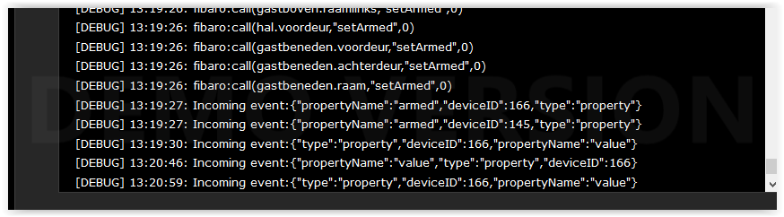

    Jan,
    Here you see that in unarmed condition motion sensor is giving "armed" why?
    I think the error is in the fact I have 2 relays I use
    One arm/disarm
    two AlarmState/ AlarmstateOff
    Now I have placed in Disarm also alarmstate.relays:off
    it seems to tackle the problem see debug 3rd picture. Must now set some message via the VD / relays.
