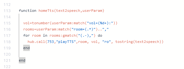

    The tts command supports only two arguments. userParam and text2speech.
    However, you can create some structure inside of userParam and to get the data in the function.
    for example
    Let's assume that always userParam will contain volume and room definition, like "vol=80:room=LivingRoom,... "
    Now inside function extract the data
    Please make sure that Sono's QA supports multiple rooms separated by comma.
    By looking in
     looks like multiple rooms  for PlayTTS is not supported.
    This is just an example and you can create your own structure
    Edited by cag014

    By looking in
    Let me know if multiple rooms are supported, if not we can create a loop to call each room
    Edited by cag014
    Yes, I can see that is taking only one room.
    Then I'll create rules for each room 😉
    or you can create a loop inside the function. (I will help you)
    let me know what you choose.
    Also I have seen that in the last version of what you sent me, the room name does not accept space between the 2 words "LivingRoom" and now I am at work (offshore) and cannot test to see if it still works the TTS.
    Tomorrow I will call my family and test it and if not, I'll use the previous version.
    You can send me whatever you think is better, whenever you have time.
    I am going to sleep now because the shift starts in 6.5 hours 😉.
    Thanks again for your time.
    Edited by silvinnio
    That should work (including spaces in the room names) for one or multiple rooms
    Edited by cag014

    Ooops, my bad. There are some messages inside QA that sent by default to homeTts function, so we need to define a default option for TTS
    Please add at the beginning of the function
    By the way now when you'll use
    The call will be redirected to the Living Room at volume 80. (Please set defRoom value as you needed.)

    Did you add the lines in function that I sent to you?
    Yes.
    This is what I have now:
    function homeTts(text2speech,userParam)
      local defRomm="vol=80:room=Living Room" --set default volume and room
      userParam=userParam or defRomm --in case userParam is null
      userParam=userParam:len()<2 and defRomm or userParam -- in case userParam is blank string
      vol=tonumber(userParam:match("vol=(%d+):"))
      rooms=userParam:match("room=(.*)")..","
      for room in rooms:gmatch("(.-),") do
        hub.call(753,"playTTS",room, vol, "en", tostring(text2speech))
            hub.sleep(500)
    But so far I did not get any crash messages. Will have to monitor.
